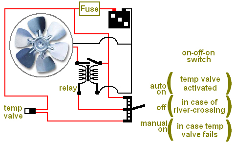

Only general comments here since it all depends on how you will plan it. So here is what I did:
1.I drew three power lines from battery. One to the switch in the cabin (it will be used to supply current at the “on” function) one to the thermo contact ( the “in” current) and one to the relay (this one will be the one actually supplying the fan). I believe that it is absolutely necessary to put a relay.
2.From the thermo contact you take an other cable and you drive it also to the switch. That is your 12V “trigger” cable for the “auto” function.
3.The output cable from the switch you drive it to the relay to activate it.
4.From the high current output pin of the relay, you drive it to the fan
5.You take a separate cable and from the “-“ of the battery you go to the ground of the relay and then the fan.
That is basically all.

το σχεδιαγραμμα ειναι δανεισμενο απο το braters.gr και τον φιλο μου τον dodo
